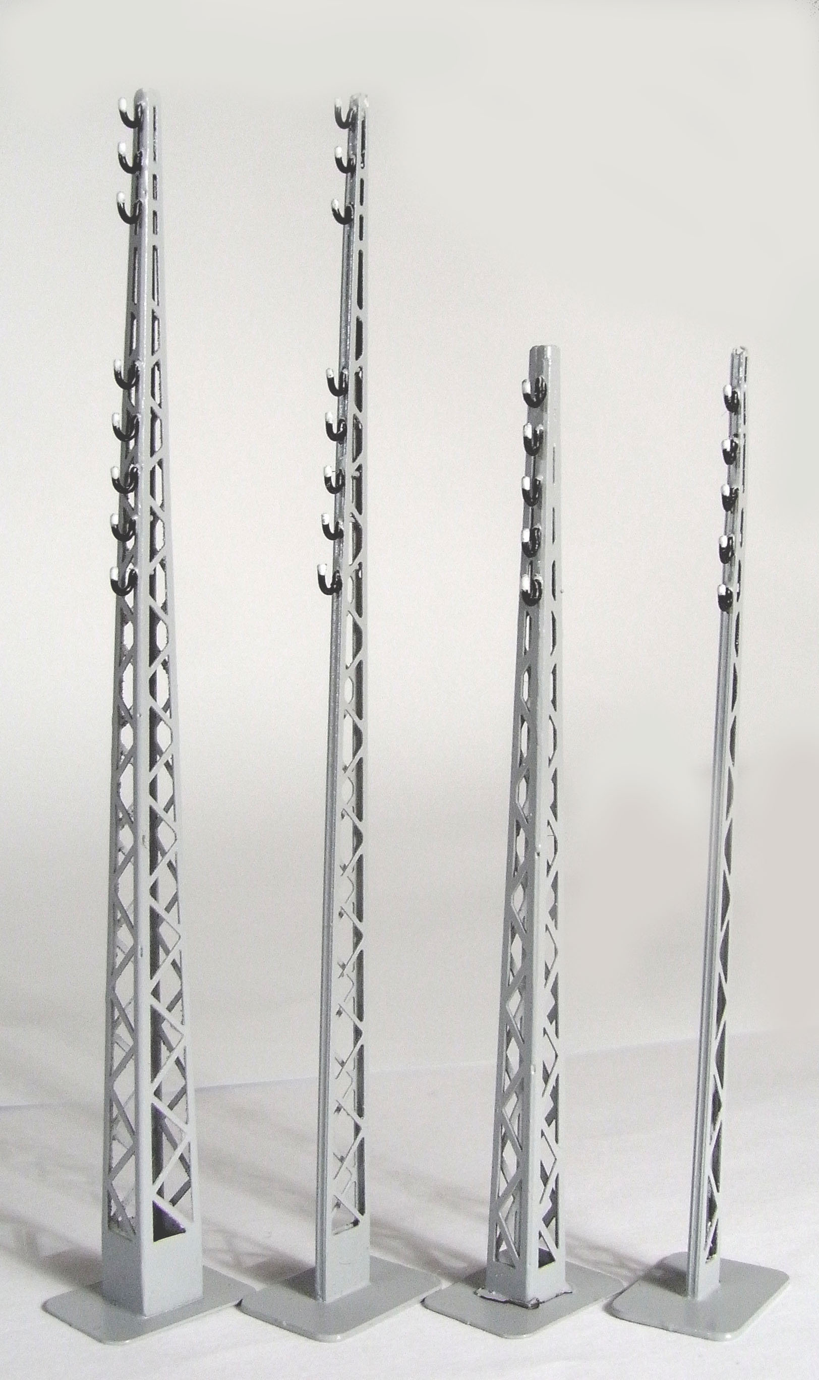

I noticed one of EpokeModeller new items: Stålmast.
There are two version (normal and kvadratisk) and two heights (6 meter and 8,5 meter).
Though I have been in Danmark quite often, I'm a litlle bit confused: Are these masts used for transporting electricity? Are they only used in larger cities (I'm sure I have seen the masts in Copenhagen) or could these masts also exist in a smaller town (like a plan to have on my lay out).
And what about the different heights: 6 meter and 8,5 meter. In what situation are 6 meter masts used and when are 8,5 meter masts more appropriate?

if it is they who are are in the picture so they can all be used in both larger and smaller cities They used to conduct electrical power between the houses . The 8 m are used normally to drive power to the streetlights so they have nothing directly to the model train to make it as some other types used to run wires and lighting marshalling areas. The small use most while square used places where tårdene be a road or otherwise to have slightly longer distance to the next mast. hope this was the answer to your question.
Hvis det er disse på billedet så kan de alle bruges i både større og mindre byer. De bruges til at føre strøm mellem husene og de høje bruges samtidig til at føre strøm til gadebelysning så de har ikke noget direkte med modeltoget at gøre det det er nogle andre typer der bruges til køretråde og belysning på rangerområder. De smalle bruges mest mens de firkantet bruges steder hvor tårdene skal over en vej eller på anden måde skal have lidt længere afstand til næste mast. håber dette var svar på dit spørgsmål.

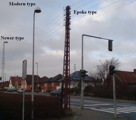

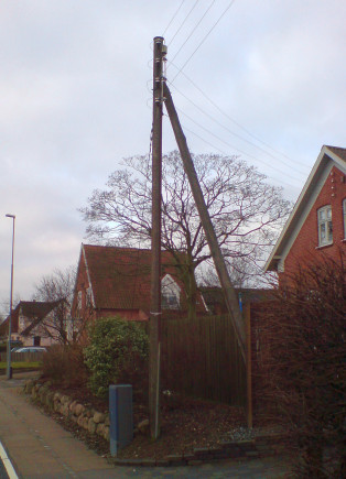

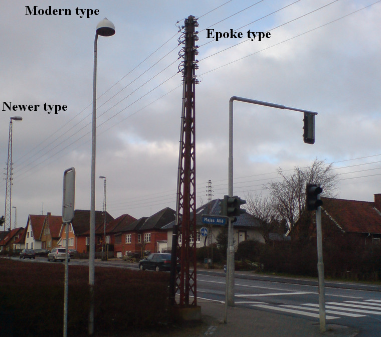

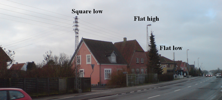

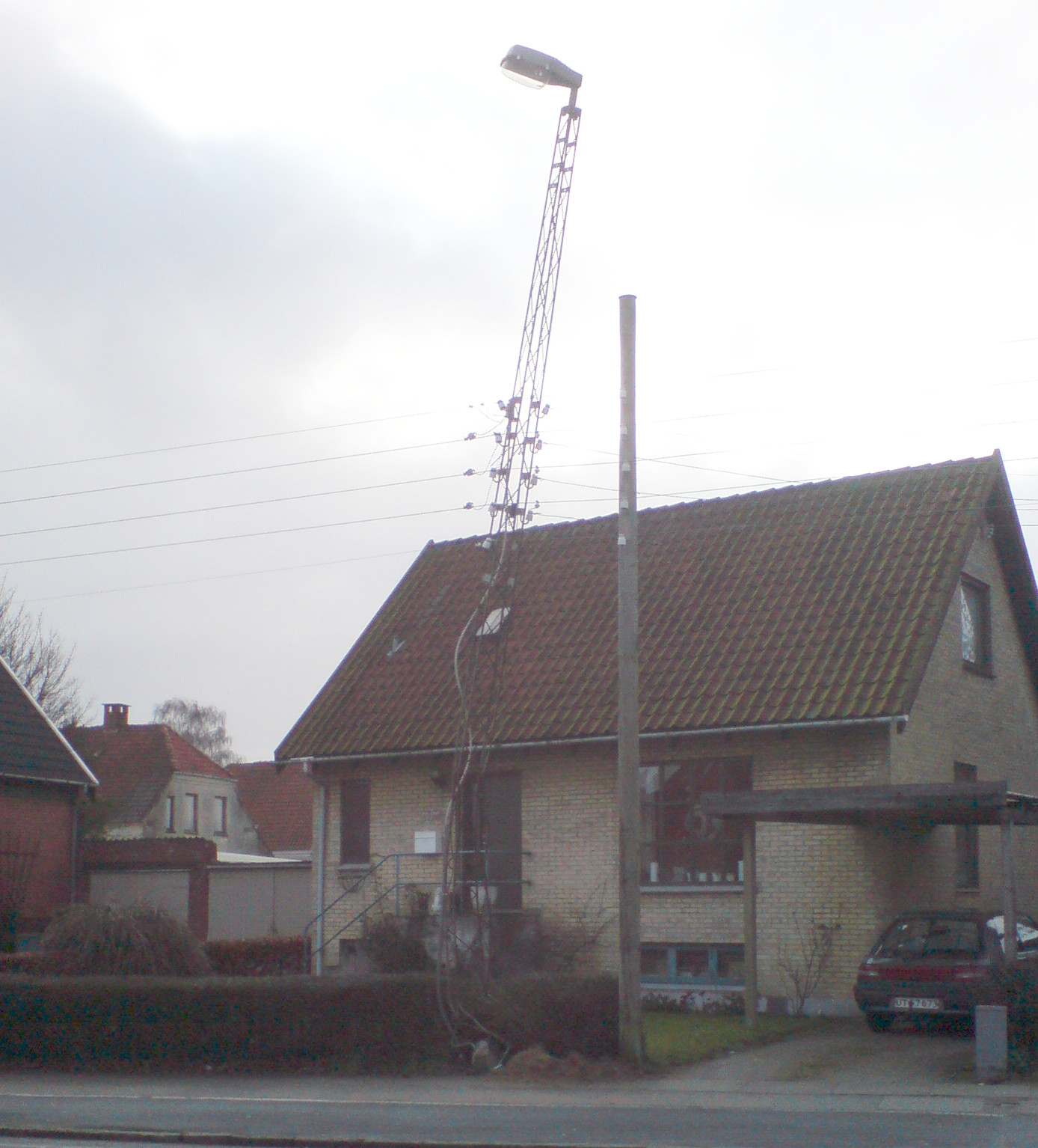

Hi Gert
I have done som practical unscientific researce in Odense, Fyn. Attached you find some pictures of how the combination of high and low & squared and flat masts can be used. The current types are a bit newer (constructed by rounds) than the masts from EpokeModeller (constructed by flat iron parts) but as far as I can remember the "newer" one are at least 25 years old and even much more, and the Epoke Model came before them. I think the two generations are used in the same way. The second picture is actually showing the Epoke type used in between the "newer" one. This example shows what coach david said. The high masts are used for lighting and the low one are in between. If the wires are crossing the road or making a more heavy turn of direction, the square one are used.
I also took a picture of an older wooden mast - and at last an example of how old equipment can help new one Wink
I actually counted the number of pavement tiles between two masts ... but I have forgotten the number. Sorry I'm getting too old. :roll:

Btw, today, in front of Odense Zoo in a road crossing, I saw 4 high squared masts with lights on top in each corner, so there is a lot of combinations.
Counting the tiles again resulted in 28-32 tiles between each mast. A tile is 80 x 62 cm so the distance is 22.4-25.6 m, and sometimes more.
